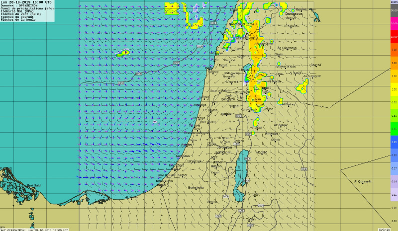

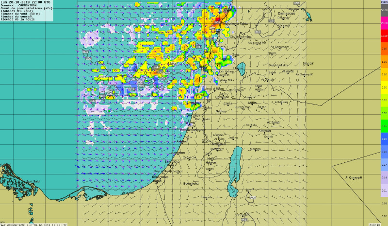

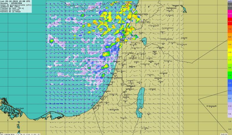

Problem in precipitation map in the WRF 4km model il y a 7 ans 1 semaine #584
I've tried with some of the files you mention and I have a changing precipitation coverage for every hour of the forecast. The current forecast also matches the IMS weather radar.
Can you please send some screen shots of your XyGrib showing the problem (a sequence of 2 or 3 hourly steps showing the problem).
Thanks,

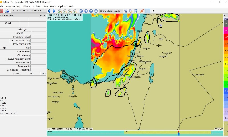

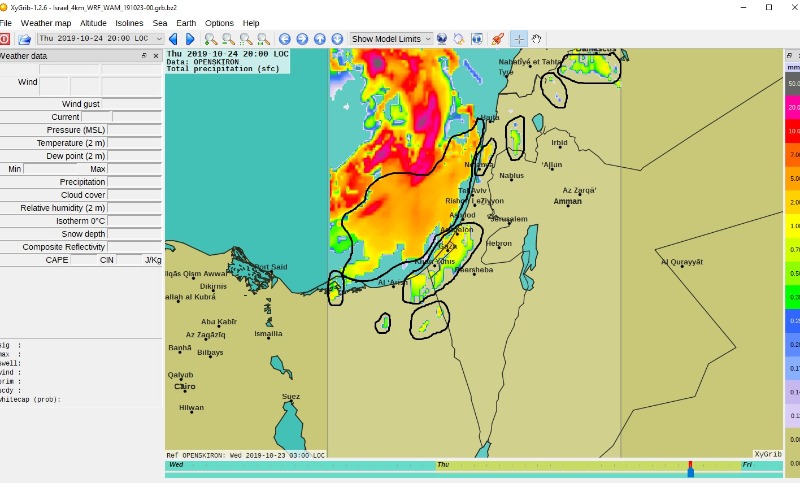

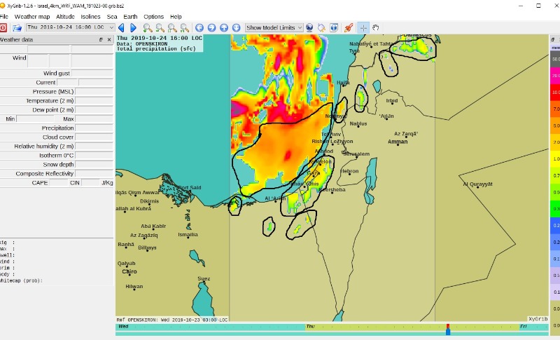

Problem in precipitation map in the WRF 4km model il y a 7 ans 1 semaine #585

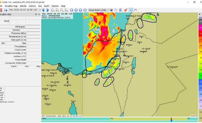

These screen shots are from XyGrib (reference date and time: 00Z23OCT2019).
The circles in black color show some examples of areas where the precipitation does not change.
This problem also occurred with charts on the website not only in the XyGrib files.
Thank you,
