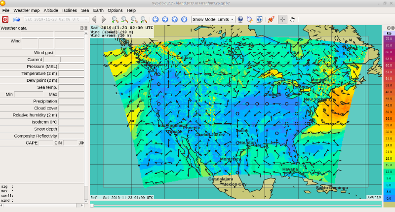

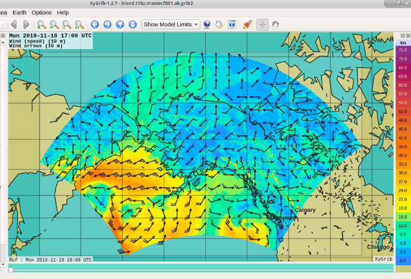

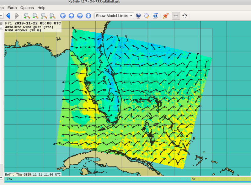

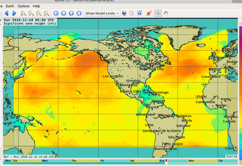

Next Xygrib version should be able to read HRRR files (Lambert Conformal projection) and NOAA site offers a sub-setter, maybe Xygrib could download these GRIB directly from NOAA?
Caveats:
- Sub-setter doesn't compress data.
- They change query layout from time to time.
Blend model could be interesting though, there's no sub-setter for it.
Sample in Xygrib:
Stereopolar, Lambert and Mercator GRIB.
