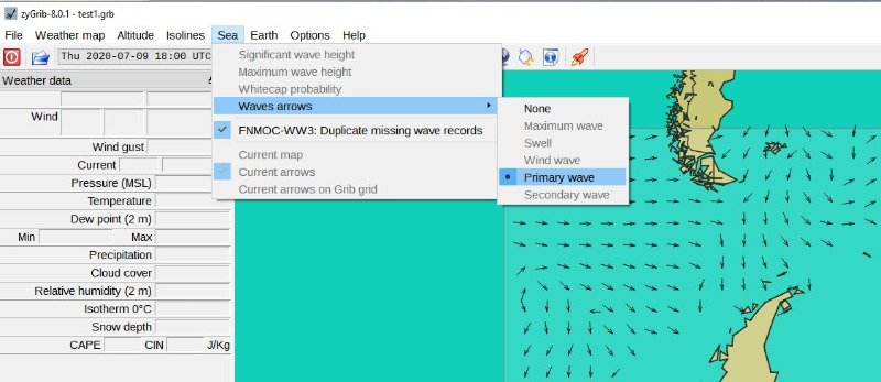

Hi Liana,

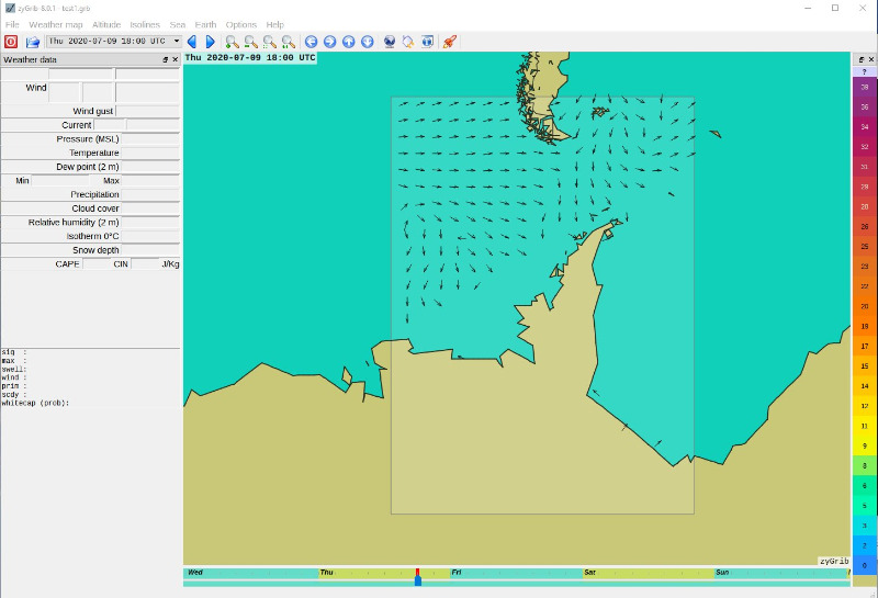

Your grib files are fine! I loaded them to zygrib ver 8.0.1 and the wave arrow show fine as seen in the image wave_arrows_01
Please remember that you need to set an option to show wave arrows in the menu "Sea->Wave Arrows->Primary Wave". This is shown in image wave_arrows_02.

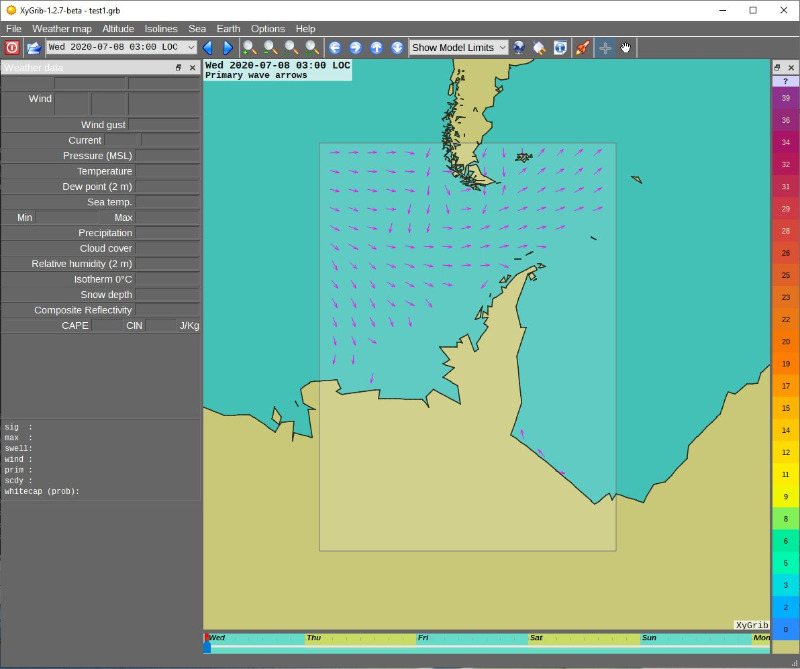

XyGrib version 1.2.6, as I already mentioned has a small bug and does not visualize the arrows. This will be fixed in the next release. Image wave_arrows_03 shows the fixed beta version 1.2.7 of XyGrib.

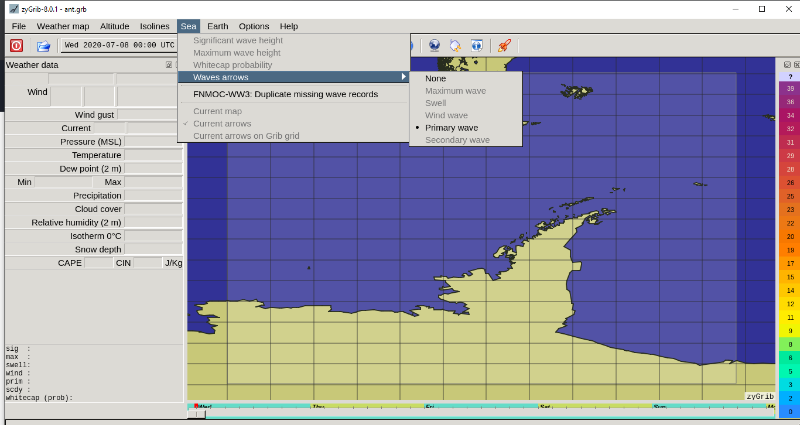

Hi, David!
That's weird. I really don't know what's going on.
My ZyGrib version is 8.0.1, I setted the option to show wave arrows (as you can see in the attachment), but I can't visualize the arrows.
I don't use XyGrib. It was just a test.

Hi, David.
I was using the ZyGrib version 8.0.1 for linux. I downloaded ZyGrib on windows and I was able to visualize the data.
So the problem is with the linux version.
Thank you so much for your help!
