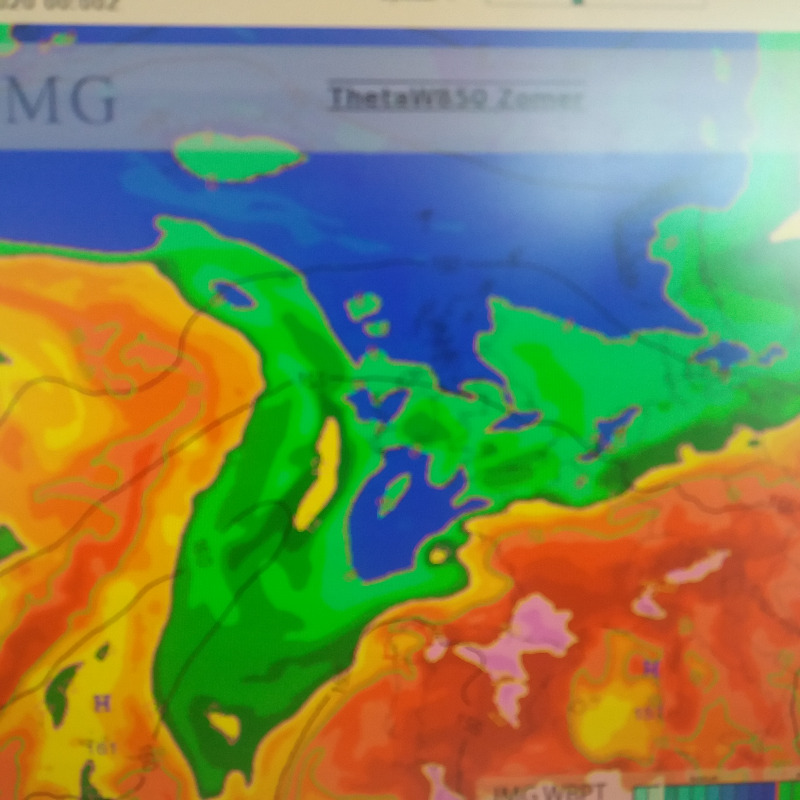

I would like to know if it is possible to give colours to values of Theta-E? In the picture an example is shown (although we use Theta-W). The polar airmass is shown in blue and green while the tropical air is seen in yellow and red. Colouring in this way makes it a lot easier to see the structure of the frontal systems.

You can modify the color scheme in the file : colors_thetae_celcius.txt found in : .../XyGrib/data/colors (... = depends how install is made)
