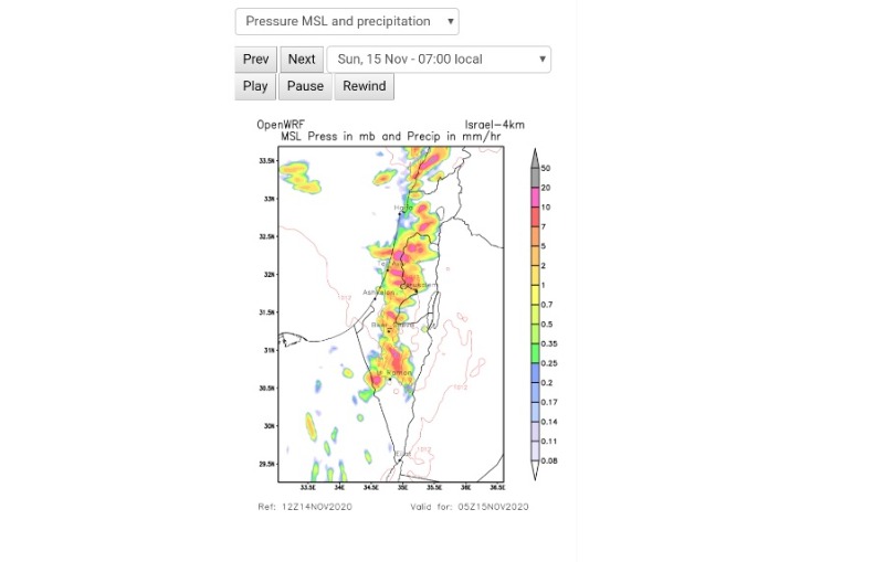

Is there any problem in Precipitation forecast in WRF Israel 4km?

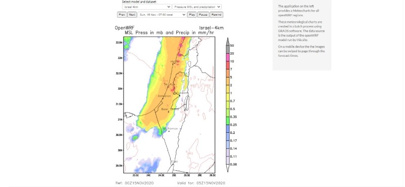

I noticed a big difference in the precipitation forecast between the last two updates (12Z14NOV2020 and 00Z15NOV2020) . In the last update (00Z15NOV2020), precipitation covers a large area in a different pattern from the update (12Z14NOV2020).
This is an example of precipitation forecast at Sun,15 Nov - 07:00 local for the last two updates.
Precipitation Forecast WRF 4km il y a 5 ans 11 mois #834
Hi Sergey,
There may be an issue. The 00z run as of today is on a newer version of UEMS/WRF while the 12z run is on a previous version. I will keep an eye on the differences and if needed will revert back one version.
Thanks for pointing it out.

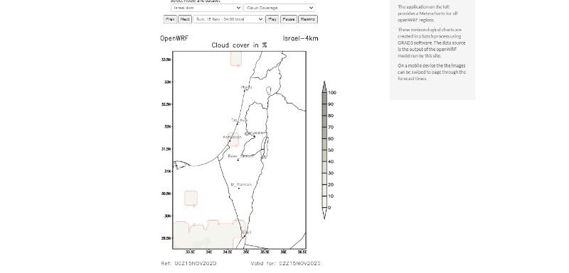

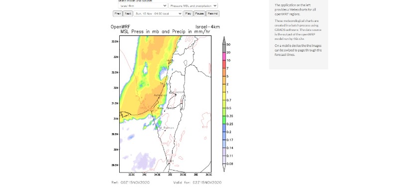

I think that this new version has a problem in precipitation forecast because today's forecast was inaccurate compared to the rain radar. Also, there was a difference between cloud coverage and precipitation forecast. There was a precipitation with no cloud coverage as shown below at Sun,15 Nov - 04:00 local.
Precipitation Forecast WRF 4km il y a 5 ans 11 mois #836
Problem is solved.
As I mentioned the 00z forecast and the 12z forecast are run on different servers. The 00z forecast today had a problem setting the run configurations and ran with an unsuitable convection module which output a lousy forecast. The problem has been fixed and the 00z forecast tomorrow should be improved and correspond somewhat with the 12z forecast.
