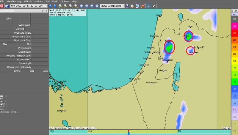

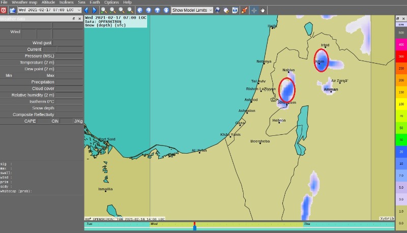

I noticed that the snow forecast for the WRF 4km model was over estimated in the last depression system in the East Med especially in Wednesday morning 17FEB2021 .
Was the over estimated snow prediction related to the micro-physics scheme or because of initial conditions of GFS model?
I have attached some screenshots for the snow depth prediction (Ref:12Z16FEB2021) with some examples with red circles.
Snow depth prediction - WRF 4km il y a 5 ans 8 mois #859
Snow parameters are not in the GFS set of parameters used for initialization of WRF. So the snow prediction is entirely internal to WRF. The snow prediction in this case was probably more affected by miss estimation of freezing altitude, as the total precipitation was estimated quite well.

Could this be fixed by adjusting the micro-physics scheme of the snow prediction to give better results?
I hope the WRF model is able to predict snow very accurately.
Snow depth prediction - WRF 4km il y a 5 ans 8 mois #861
It involves much more than just the micro-physics scheme. Precipitation is also an outcome of the cumulus related schemes. Isotherms at height levels are determined by other schemes. It would not be wise to start adjusting a well balanced model with good prediction performance unless a systematic error is noticed and there is the possibility of firm evidence of what the true measures were over a significant time period.
