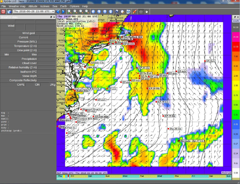

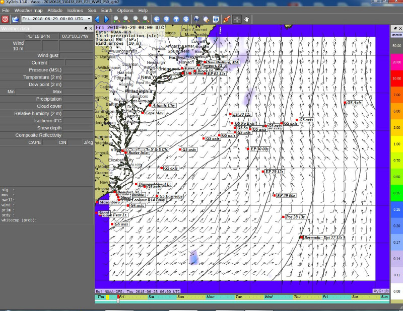

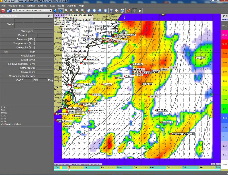

I am attaching 3 images spanning 6 hours, #1 showing rain 6-29-21z, #2 showing no rain 6-29-00z, and #3 again showing rain 6-29-03z

Here the 3 images I sent before. They are from the GFS model. I am not seeing the same issue, (missing precip imagery in ICON or Arpege
