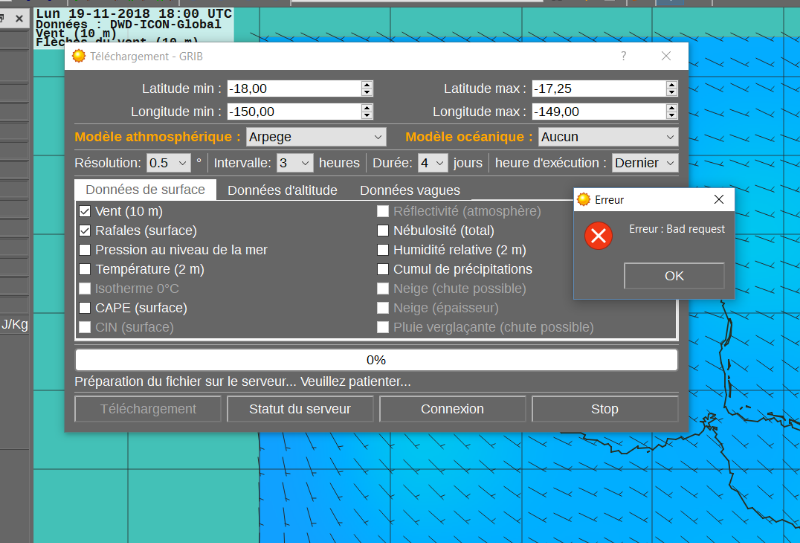

Unable to download ARPEGE model il y a 7 ans 11 mois #263
thank you for your answer.
Here is what I get when I select ARPEGE just the same way I used to on the older version.
Unable to download ARPEGE model il y a 7 ans 11 mois #264
Are you having the same problem with GFS for the same selected rectangle? I suspect that you will have the same error.
I tried to get the same grib as you requested both on Windows and on Linux and had not problem with the interface in English and in French
As I suspect that it has to do with the decimal symbol being a comma instead of a point, please try to change the language of XyGrib to English, restart XyGrib for it to take effect and then try to download Arpege again.
If this works then you have an issue with the locale of your computer. Please check what region the locale is set to and let me know.
Thanks,
Unable to download ARPEGE model il y a 7 ans 11 mois #265
I get the same results when switching to English (although the comma is turned into a dot) except for when I take a larger area (whole Society Islands for instance), end even stranger, once I have downloaded the larger area grib files, if I try to narrow my search, none of the 3 models work.

Unable to download ARPEGE model il y a 7 ans 11 mois #266
Just noticed that I cannot swicht back to the older version. I made then several tests :
- language doesn't seem to be an issue, because I also get error messages when english is on.
- it seems that it has to do with the size of the area that is defined by clicking and sliding on the map. While I could just get the sample I want with the older version to get 3 models (IOT corroborate the info) - most of the time Moorea and Tahiti, this is no longer possible and if I have to make a bigger selection (the whole archipelago).
Strange and a bit annoying but I can always zoom in.
