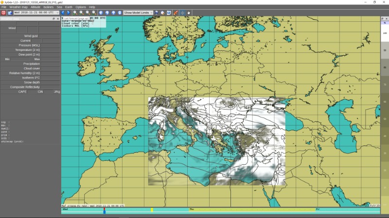

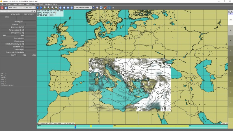

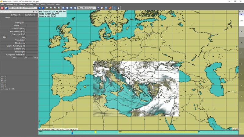

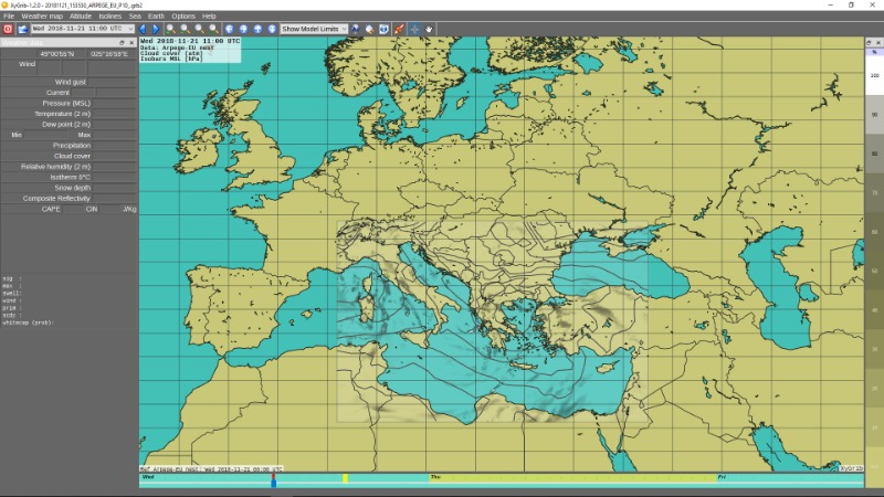

To try and get to the bottom of this kindly load a file that gives you the problematic cloud display, take several screen shots at 1 step intervals that include the entire application including the color bar on the right.
Please post the images here and also post the same grib file (you will need to zip it first).

Hello. You can download the files from here.
wetransfer.com/downloads/c0e9529448780e9...0181121164835/4564dd
You don't permit files greater than 2Mb.

Thanks for the files. Please leave the grib file online for a while as I will ask someone else to take a look.
I found the grib file to be perfect and I do not have the same cloud issues on every second time step. This is related to your particular computer for some reason.

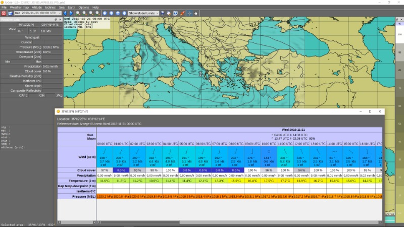

I kindly ask you to do one more check. Please create a meteo table on the center of Cyprus as this shows cloudy at 0800 1000 and 1200 UTC but clear at 0900 and at 1100. Does this occur in the meteo table too or are the values cloudy (near 100%) for all hours 0800 to 1200 on Wed the 21st?

In a previous message I said that they are consistent , I meant Weather Data Board, meteotable and graphics, all of them are showing the hole in the data. Today I opened the same data that I sent to you and the hole is in different hours. In the image you can see the meteo table that you asked. If I closed and reopened Xygrib the clouds seem to be ok but If I loaded the grib file from file or download a new one there is a big probability to cause again a hole in the clouds (only). If you think there is some other test or debug I can do for you I am at your disposal .

Regarding the cloud issue: I have opened an issue for this in our github area and I suggest waiting to see if the problem occurs again with other users or if we are able to replicate it.
