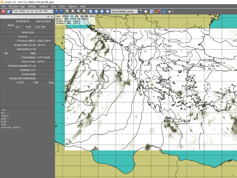

Please also try to set cloud 100% to dark (this is in the options->graphic parameters dialog for the main window and can be separately set for the meteo table in the meteo table window options).

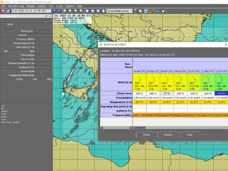

Icon cloud isseu il y a 7 ans 11 mois #274
  • pat
  • Portrait de pat Auteur du sujet
  • Messages : 9

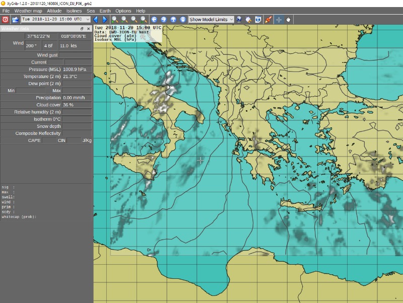

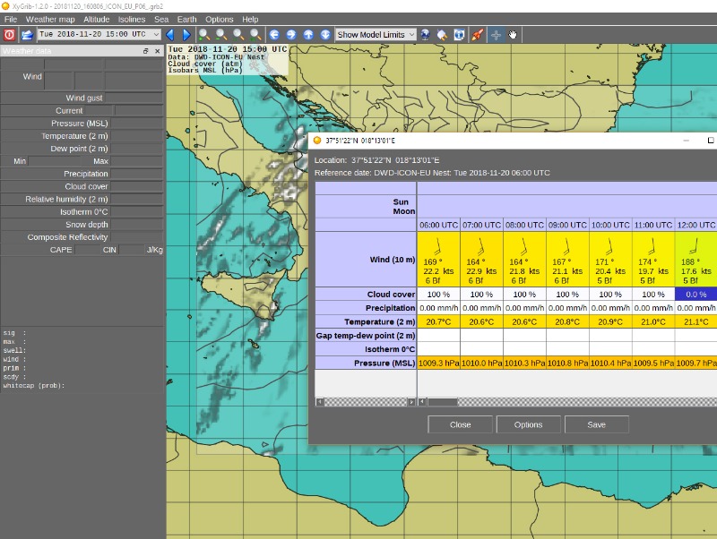

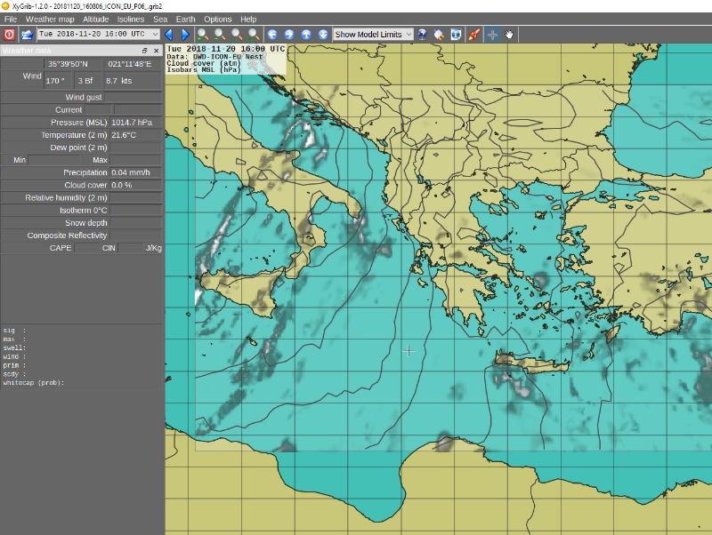

In the images attached you can see that for the point in map where my mouse is pointing the Weather Data Board shows cloud cover=0% but the meteotable is showing 100%. The last image is with the option "cloud 100% to dark". Surely I will try in another computer but I think you are interested to investigate it.
Gian
Icon cloud isseu il y a 7 ans 11 mois #275
  • pat
  • Messages : 9

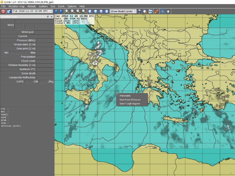

More images ..
Weather Data Board -> 36%
Meteotable -> 100%
The resolution of my display settings is 1920x1080 (maybe ban help)
Gian
Icon cloud isseu il y a 7 ans 11 mois #276
  • Portrait de DomH
  • Modérateur
  • Modérateur
  • Messages : 110
  • Remerciements reçus 26
pat écrit: In the images attached you can see that for the point in map where my mouse is pointing the Weather Data Board shows cloud cover=0% but the meteotable is showing 100%. The last image is with the option "cloud 100% to dark". Surely I will try in another computer but I think you are interested to investigate it.
Gian
The chart shows data at 1600 UTC
The meteotable from 0600UTC to 1200UTC.
Cloud is 100% from 0600UTC to 1100UTC and 0% at 1200.
If you could check again to be sure.
Icon cloud isseu il y a 7 ans 11 mois #277
  • pat
  • Messages : 9

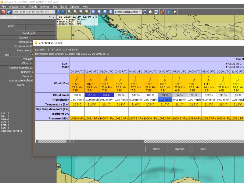

I am sorry you are right. I didn't read correctly the meteotable. They are consistent. In the image that I attached here you can see that it seems there is a hole in the data (00:00 UTC cloud cover=100%, 01:00 UTC cloud cover=0%, 02:00 UTC cloud cover=0%,03:00 UTC cloud cover=97% . But If load the grib data in another software it seems to be ok.
