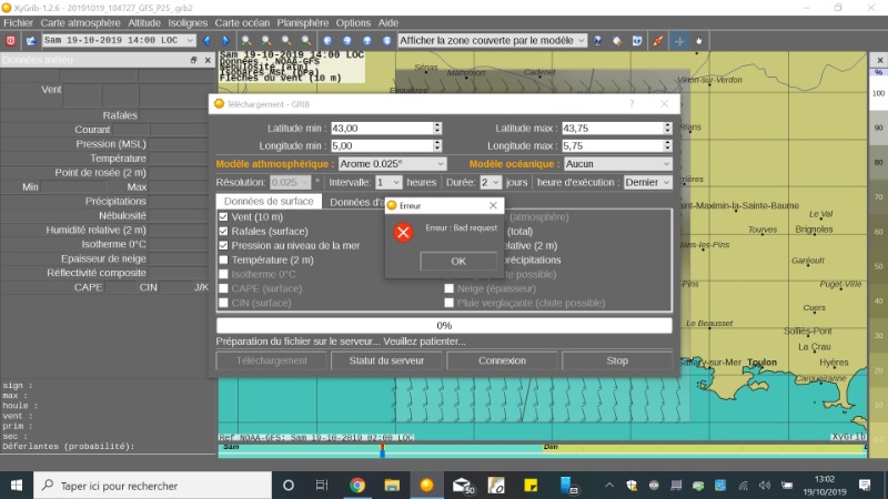

erreur bad request 7 years 1 week ago #574
bonjour
j ai une erreur BAD REQUEST qui revient régulièrement voir image jointe . comment faire pour résoudre ce problème merci
erreur bad request 7 years 1 week ago #575

erreur bad request 7 years 1 week ago #577
OK....
I can see the problem and I was able to replicate it.
You need to request a slightly bigger area. If the requested area is too small the request will fail.
I have listed this to be fixed in the next version.
I hope this helps.

erreur bad request 7 years 4 days ago #579
Hi Jacques,
The problem was on the grib server side and it has now been fixed.
It is possible to download grib files less than 1x1 degree.
