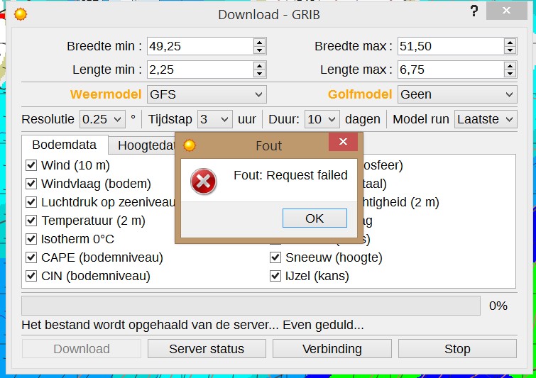

Dear
I have this a few times a week. What's wrong?
I miss XyGrib!!
Tom

This happen with GFS model, not for other models.
We are looking why this happen.
Thank you for your patience.

NOAA has been experiencing serious server problems during the last week including over the weekend.
This almost totally disabled the ability to download GFS and NAM models from the NOMADS distribution center
They are not yet fully back online and I expect that there will be problems for the next few days

Oké, but in ZyGrib for example, there is no problem.

Perhaps it is not using NOMADS subset server as the source but it takes the full set via ftp?

zygrib has not been updated for a couple of years (2016) and still get the old version of GFS data.
