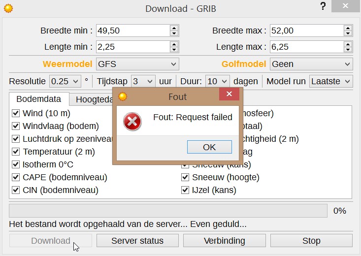

Request Failed 4 years 9 months ago #900
Dear
I have had a request failed every few days. How did that happen?
thanks
Request Failed 4 years 9 months ago #901
For the last week NOAA has been experiencing problems with their made FTP service for several models including GFS.
In the last 48 hours the service has stopped completely. There is an option to download GFS for the NOMADS Grib Filter but this requires a completely different setup of the data preparation scripts.
Until the problem is resolved - I suggest using ICON as an alternate global data source. This is working in XyGrib without any problems.

Request Failed 4 years 9 months ago #902
GFS is now partially back online.
Forecast for 00z is now in the XyGrib grib server
