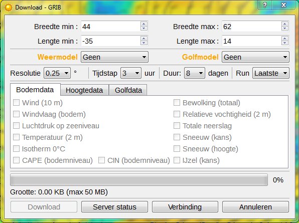

Hi there,
First let me compliment the team who is working to make XyGrib better and better. On the latest version, however, when I restart the application (or start a second instance to compare the models) and want to download a new run, default all the models are set to none and all the parameters are unchecked. Previous versions of XyGrib memorized which parameters and models where chosen the last download session.

Metbriefer wrote: Hi there,
... want to download a new run, default all the models are set to none and all the parameters are unchecked. Previous versions of XyGrib memorized which parameters and models where chosen the last download session.
This bug has been seen yesterday and already corrected for the next release (see github.com/opengribs/XyGrib/issues/97 and github.com/opengribs/XyGrib/pull/100), even if in the linux version I have, this did not happen.

Please check version 1.1.2 now released. This bug has been fixed
