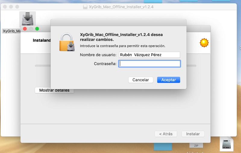

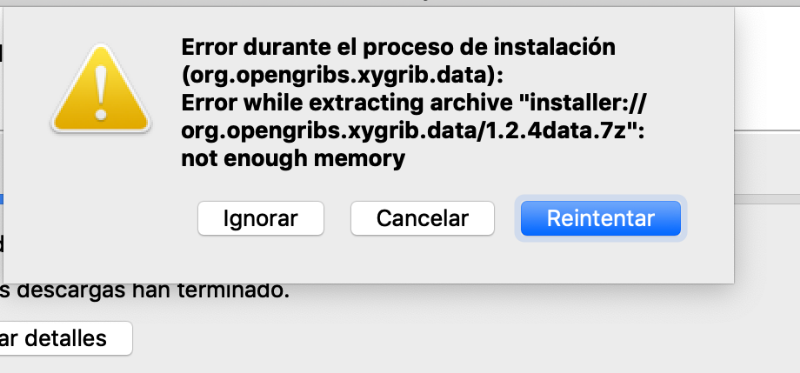

Good afternoon, first of all give thanks for the work you do. I have a problem installing on mac. I have version 10.14.2 (18C54) of mojave. When I install it gives me an error and it does not let me continue. Assistant screenshot. What can happen? I have tried to uninstall and reinstall and nothing.

The error message that the installer is giving you regarding "not enough memory" is a small bug in the Qt installer system that we use. It reports this when administrator rights are not given when requested by the installer.

Please make sure that you enter the administrator password when the install program requests it. Note that the dialog may have been covered by another window.

I think I have seen a pop-up window that escapes from the screen out of the reach of the mouse, I did not have time to see what it said, just after putting the password. If you have any advice about changes or restore factory parameters of the mac, I will have no problem doing so.

My session on the mac is always as administrator. Do you mean that when I turn it on I enter my username and I enter the administrator password?, I do not enter as a guest? If so, I always go in with my main user and enter the password.

Even though your user account has administrator rights there is still a need to provide a password on many system related actions including some installations.
XyGribs needs these rights during installation and therefore asks for your password to apply your administrator rights during install.
This happens on every install on Mac OS (as well as other operating systems).
