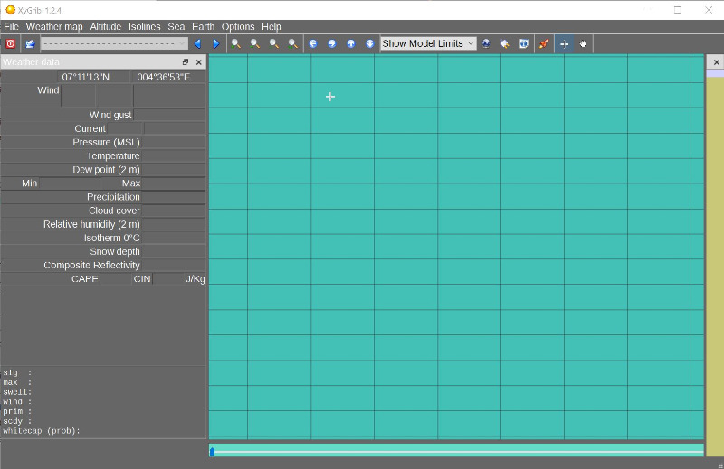

On my WIN10 computers, the xy-Grib 1.1.0 version works fine.
All subsequent versions with WIN Online Installer (including 1.2.4) will not have a map view, so they will not allow range selection and grib download.
What am I doing wrong?

map display 7 years 6 months ago #446
Hallo David. Thank you for quick response!
I performed the following:
1. Uninstall the current version via Windows Control Panel done
2. Remove the entire folder with version 1.1 wherever it was unzipped (look for an XyGrib folder done
3. In the user folder (the one with my name) open AppData\Local\opengribs\XyGrib\ and delete the two ini files done, but there is only one (see below)
4. Then open <user>\Roaming\openGribs\XyGrib and delete the entire 'data' folder structure done ( in the first session, this folder was empty, in the second the “data” available)
5. Reinstall ver2.4 using the installer program done, but the same negative result, see attachment
Thank you
Joerg
Xygrib.ini
[main]
gribFilePath=C:/Users/J\xf6rg/xygrib/grib
appDataDir=C:/Users/J\xf6rg/AppData/Roaming/openGribs/XyGrib
appLanguage=en
colorMapData="250;105;10"
showPOIs=true
showMETARs=true
mainWindowPos=@Point(0 0)
mainWindowSize=@Size(1465 934)
map display 7 years 6 months ago #447
it might be connected to the user name with a backslash in it
J\xf6rg
